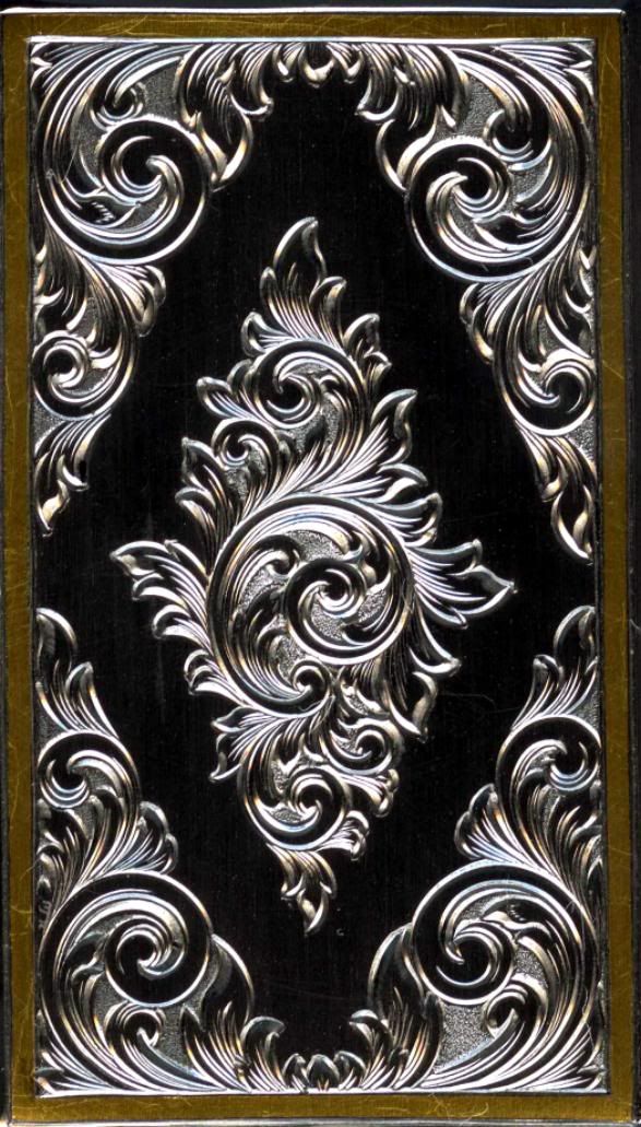

John and I have been discussing engravers and how long it takes. This was done this morning while I was reading emails, drinking coffee and and scanning photos and stuff.So, I guess about 3 hours of actual work. It is one and nine sixteenth inches tall.

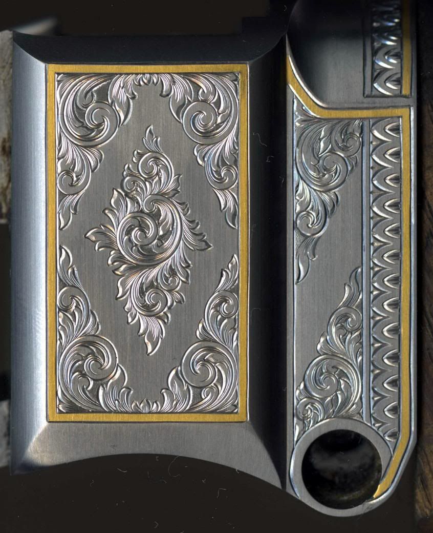

Now I have done the same on the other sides and am cutting the border, when I realize I use a simple method to layout repetitive borders that someone may be interested in. Anyone can eyeball half way. So first I make a mark in the middle, cutting the border into two sections. Then I do the same in each section, cuting it into four sections. On this one I then subdivided each quarter into three, ending up with twelve sections eyeballed, which you can see marked in pen, and the cuts being started to make the border of arches. For years I used to use various measuring techniques to do this, which all took a lot of time and tools, this takes less than a minute with only a pen or pencil.

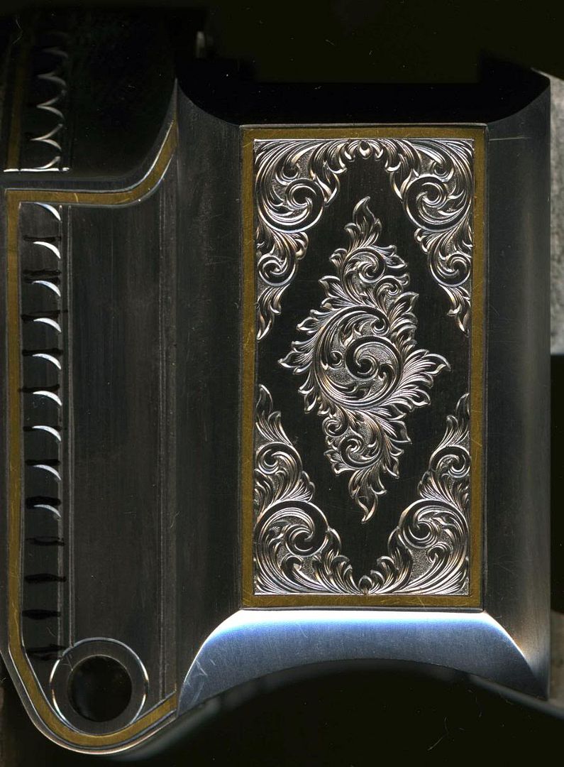

Then I just added some cuts till it looked pretty good. Could it be done better? of course. But in the hand it looks quite respectable. This is what I call 90% work, it can be done at a reasonable price in a timely fashion. 100% work is what we all like to do, but that last 10% really kills you.
