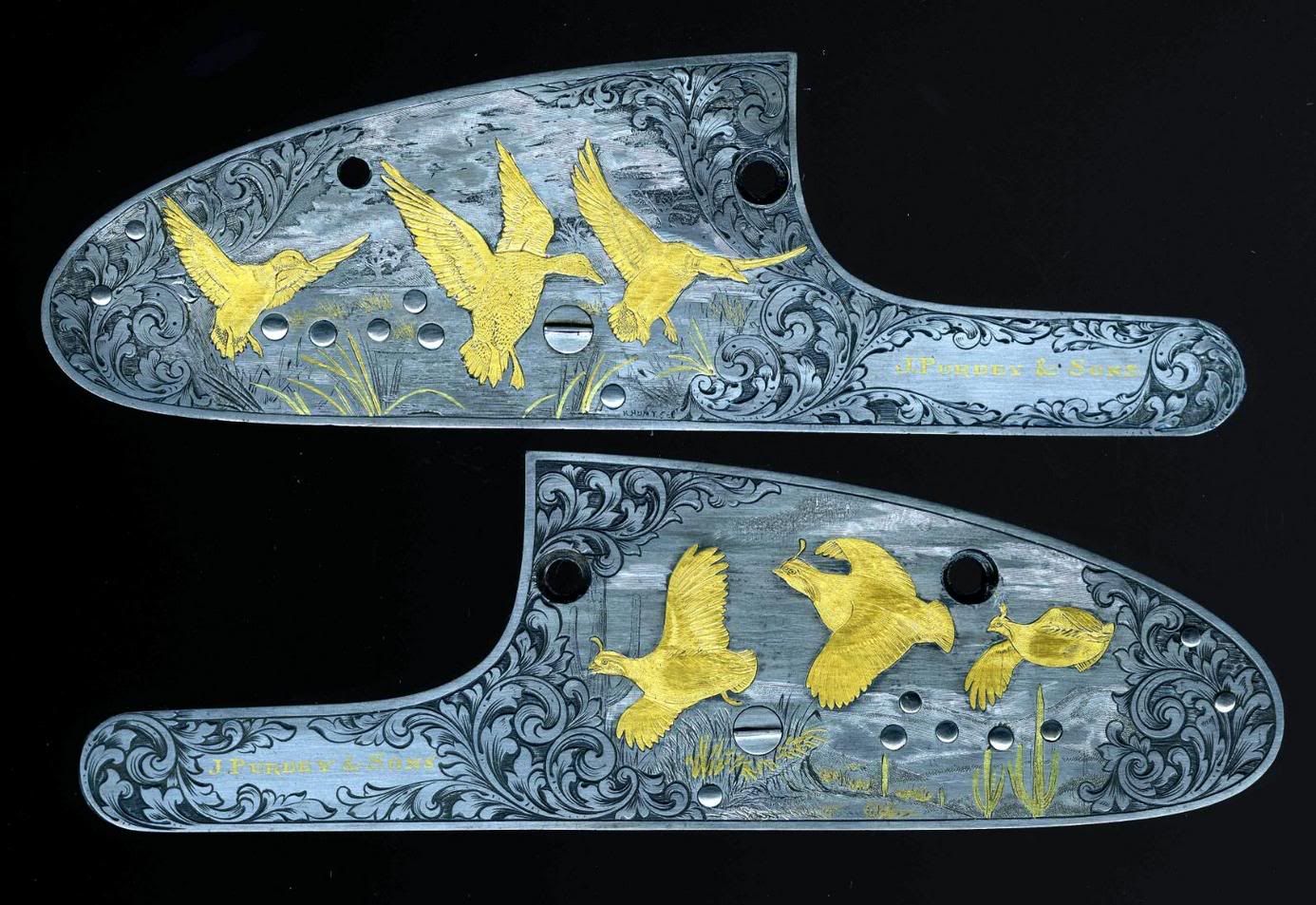

I have been sent some interesting locks thet need some repair, I thought maybe it would give us something to chat about. Let me know what yoou think of them...

Nice locks Barry. What do they want you to do to them? Also..what type of camera did you use to photograph them? they look pretty clear
Martin Rabeno
11/27/2005 9:47:13 AM
Hi Marty, long time no see my friend, nice to hear from you. You may notice there is a piece of tape holding whats left of the #1 duck on the right lock in place. It came in for repair. I scanned the locks on an epson 4870 photoscanner,at about 1200 dpi then cropped, enhanced and reduced the size a little so they would not be too huge....There is a lot of history and a long story behind these, but I do not know all of it, I am hoping someone might know more of it.

So, Barry,how long you figure before the rest of the inlays fall out? Sam

Barry, it appears as though there is an engravers mark just below the scotch tape. Could be K Hunt from what I can tell without a magnifier. Just wondering if it was. Mike

Hi Barry, will you let us know if the inlays are sheet or constructed wire, please?
Mike, I an almost sure the mark is K. Hunt '56.

Hi Sam, the rest of them are in reasonable shape. I think there were some burrs poking through when it was first done which allowed water to seep in and caused rust which pushed up the inlay, or it may have been polished during one of its many refurbishments, causing the burr problem.
Mike,the mark is K. Hunt.
David Trevallion is researching this, the beginning of the story at this point is this was done by Hunt, at Kell's shop on Broadwick street in London, while he was still an aprentice.
John,It seem to be a constructed wire Inlay, and there are burrs and an undercut around the edge.
I will restore it with the minimal disturbance, stabilizing the loose gold and leaving the rest.
The left hand lock is fine, does anyone have any observations on it?

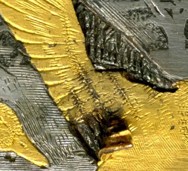

Here is a closeup of the cavity on the right lock..

re. left side - spelling

Barry, is it the photo or is there a lot of steel bits showing through the gold? Also, as John Vukos notes, the "R" on the left side looks more like a "U". Is that also the photo or is it a "U"? I don't envy you the repair job!

Barry,
Thank you for the information about the composition of the inlays and your work in
posting this most interesting project.
The most difficult part that I have found in this type of repair is in creating a new, sharp burr field in the already somewhat overworked steel.
With the help of a microscope and you fine skill, I know you will make a wonderful job of it. Please post a photograph of it when you complete it.

Thanks for the great comments everyone.The R is an R it just looks funny because of the lighting. And the left lock is a different engraver, any guesses? I hope we are having fun with this. The repair is underway and I have pics if you wish to see them. This pic is shows that I have protected the surface with rebite ground, in preparation of etching out the rust with acid.

Lynton McKenzie?

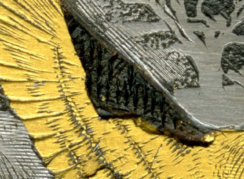

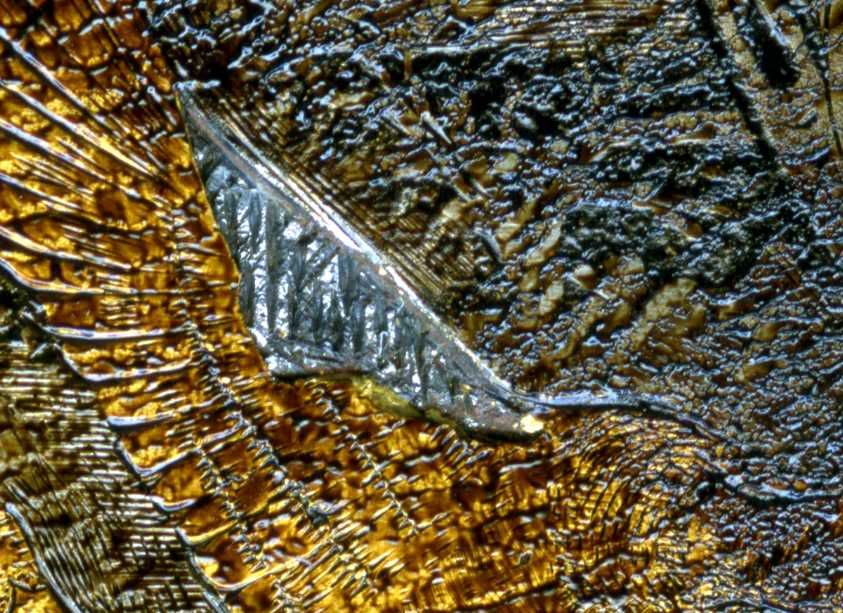

After etching the cavity I got to poking around and pulled this up...I call this pic "duck wing shredded" So I did the same operation in here.

Fred, you are correct,good work, thank you for the observation.

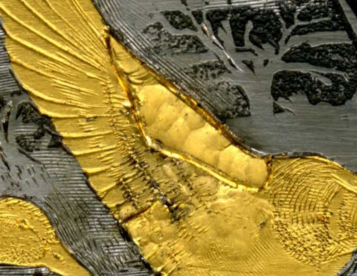

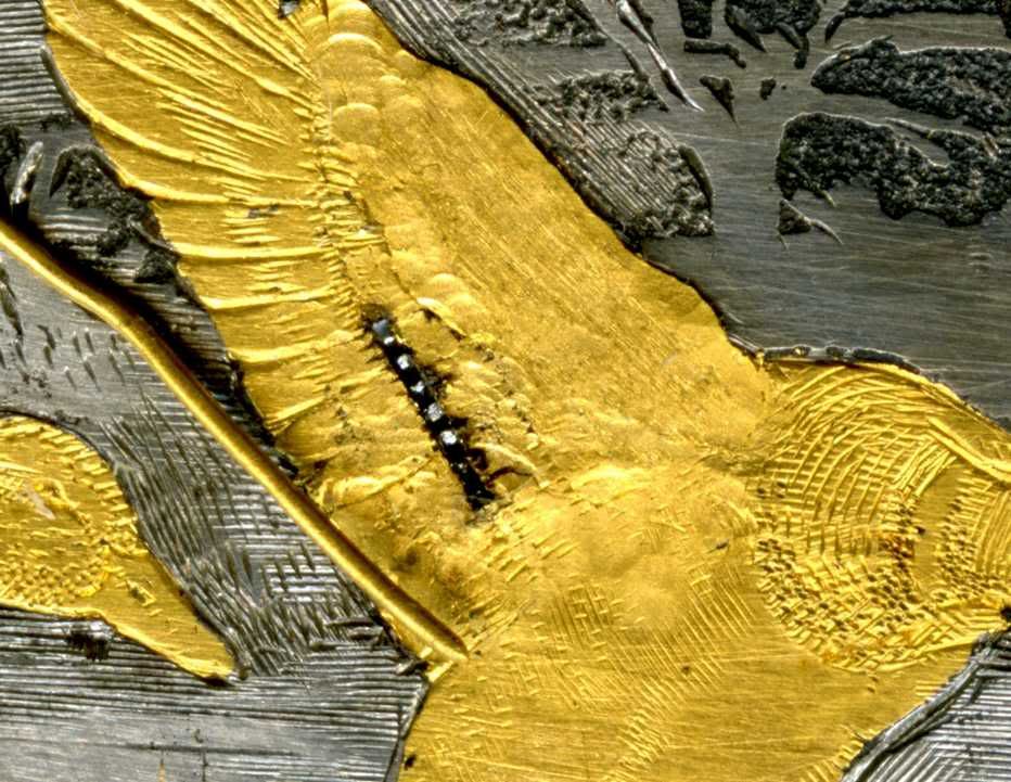

Here is the next stage, wire trimmed, flattened a little, with a line cut between it and the old metal, so it will have a tight seam when flattened completely.
Barry Lee Hands
12/1/2005 12:08:55 PM
now it has been punched down, and is being stoned.
Barry Lee Hands
12/1/2005 12:30:27 PM
Next I cut a channel through some of the steel poking through and raise teeth to recieve a wire.
Barry Lee Hands
12/1/2005 12:32:47 PM
the wire is installed, the area stoned,
Barry Lee Hands
12/1/2005 12:35:32 PM

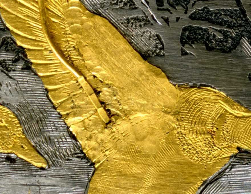

and the detail is put back in.
Barry Lee Hands
12/1/2005 12:37:47 PM

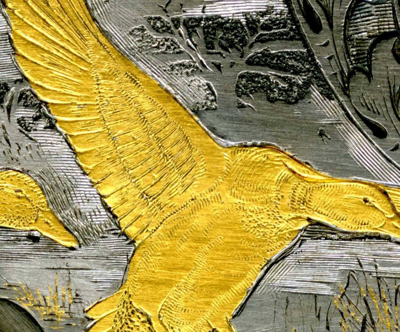

And the locks are cleaned, and returned to the client.

Excellent job Barry. When you said you "boiled" the piece just what did you mean? Do you plan to do the wire repair on areas of the other inlay showing a lot of steel? I had assumed the gun had been used a lot. The last time I talked with Frank Hendricks I asked what he was working on and he said he was repairing some gold inlays and that he had done several of these jobs...all KH. S

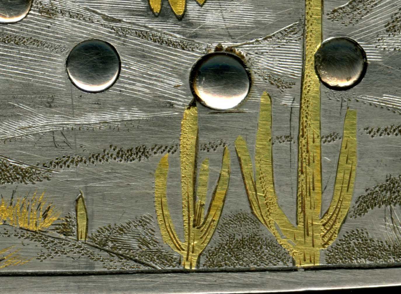

Here is a closeup, the color is not so good, but he was using yellow and green gold together all the way back in 55 or 56
Barry Lee Hands
12/1/2005 2:15:14 PM
Here is a closeup, the color is not so good, but I thought it was interesting that he was using yellow and green gold together all the way back in 55 or 56
Barry Lee Hands

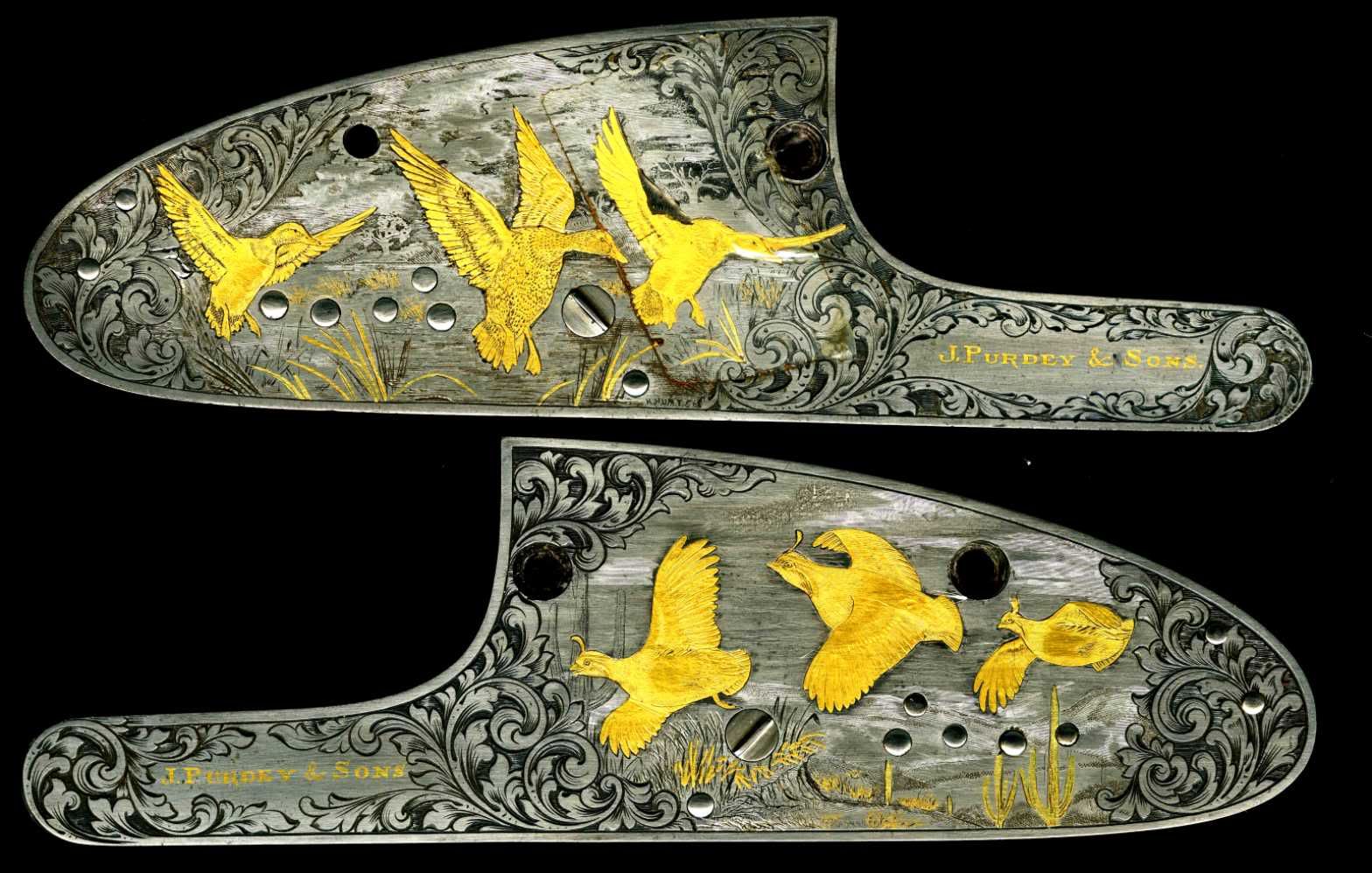

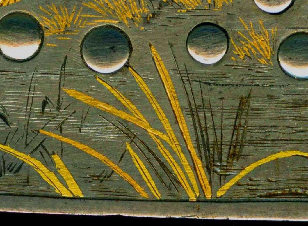

P>S> here is the Lynton side where he used yellow and green also.
