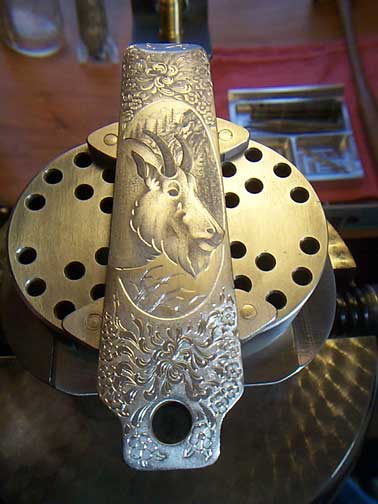

Thank you very much Andrew for the information, it was very usefull. Thank you. And per upon your request here are some photos of a floorplate I just finished up this week. Thank you again. M A Smith

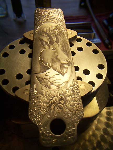

Another photo of the floorplate - slightly different view.

Hi Mark
It's a pleasure to meet you.
Glad I could be of some help. That floor plate is just beautiful. I love the sylised mountain goat. I'd be very keen to see some more of your work. Your old master sounds as if he was a real character. Do you use the traditional hammer/chisel/burin for your engraving or air assist? Or all of the above?

Ron, very nice pistol. Bring that one to Reno. Mark, it's always fun to see work by another engraver expecially a style that is new to me. If you get a chance come to Reno. I think you will really enjoy meeting the crowd and seeing the engraving and I know everyone there will enjoy seeing your work and meeting you. Congratulations both of you on very nice pieces.

mark .. just beautiful work on that floor plate i would like to see more of your work .. like lee said try and get to reno i know you will get a lot out of this show .. hope to see you in reno .. ron p.

Mark: A belated welcome to the forum! Thanks for your posts and photos! Very nice work and in an interesting style. It's always nice to other people's style of engraving. Did you bead blast the background behind the scroll?

To Andrew my friend: I have primarly three work stations; the first station is where I use a modified foredom recipicating power assisted hand held piece, its very similar in appearance to the neumatic hammers and it is almost identical in size and feel as my hand held ones. I've modified it to run 20 to 4000 impacts per minute and have made other minor modifications. I tried to use a neumatic hammer once but the slight hissing sound that came from the unit (I believe it was a gravermax) bothered my hearing (and yes I do use a hammer and chisel and hand engravers), I used multiple multi faceted bulino picks in engraving the goats head and all the shading on that floor plate. I use all traditional style and techniques.

To Rex Pedersen: Thank you for the warm welcome. It is an honor to hear from you; I am also familar with your work and have also read your bio with GSR and viewed your work in other publications. I would consider bead blasting a blasphemy considering my training and studying. All the light reflection you see behind the scrolls is a part of the bulino process from light absorbtion to light reflextion as you know. The photos didn't show nearly the detail I was hoping for, but all the shading was done in dot bulino--using dots not lines, in this case. Everyday I am studying new styles and techniques from the Austrians, Italians and Germans, Americans and the English. I have many books, many German books and catalogs, and most of the American published books on engraving and am now acquiring all the Italian books I can find and purchase. Most of my tools are very old, far older than I am (I believe) except for the ones I have made and my power assisted ones. Each time I pick up a hammer and chisel I feel it very rewarding that I am chiseling into a piece of steel in the same fashion and enthusiam as my engraving brethern before me.

Mark,
Thanks for the response. It was really hard to tell from the photo just what method you used. It had a very nice effect! I'm looking forward to seeing your work in person in Reno!
