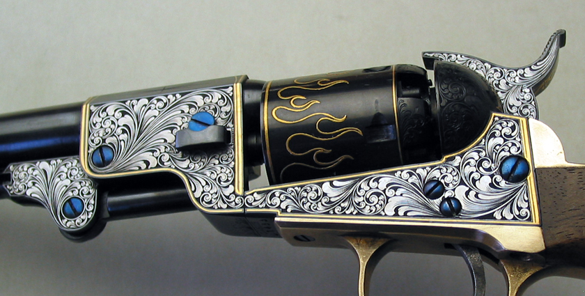

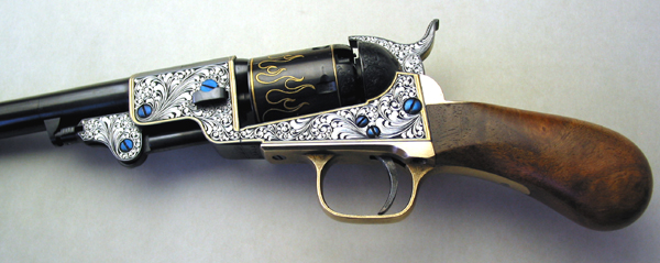

Thought those of you who weren't in Reno would like to see the nearly finished shifter knob for my 1928 Model A pickup truck. The trigger is the horn button. I say nearly finished because I will add some scroll on the brass grip frame. The gold flames are to match the flames I intend to paint on the hood. This is a floor shift tranny (1939) and the shift column is made of rifle barrels so a wire can be passed up to the cylinder for a grounding button. When you pull the trigger, the hammer goes forward to ground the horn. Not shown in the photo is the shift pattern and the word HORN in gold on the back of the recoil shield and hammer.

A close up of the scroll work

are the scrolls brightcut after the gun is blued? how do you do that peticular type of finish. it's awsome.
K. David Gruber
5/8/2006 9:03:33 PM
David, the scroll work was cut with a square carbide tool in the usual manner, not bright cut. After the parts were run through a hot dip bluing tank, the blue was removed from the scroll areas using Oxysolv, a product sold by eastwood.com for the auto restoration crowd. It is a rust remover, similar to Naval Jelly, only more liquid in form. It leaves a much more uniform finish than Naval Jelly and requires almost no rubbing with an eraser. I painted chipout ground around the edges and then dobbed the Oxysolv on with a Q tip, then rinsed with hot water. Done! A light oiling followed. You can just see an area of the same scroll work, retaining the blue, on the recoil shield. Regards.
Sam Welch
5/9/2006 8:54:09 AM
PS...the chipout ground was removed with alcohol. It had not dried but for a couple of minutes so a stronger solvent was not needed. I am told that fingernail polish works just as well as chipout but I have never tried it. Should do that sometime just to see. The chipout is expensive due to shipping costs.

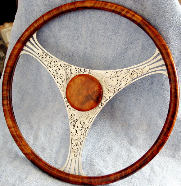

Here's the steering wheel.
It was cut from 1/8 inch stainless and the pierced scroll work is 1/16 inch aluminum.

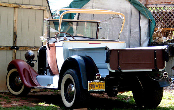

1928 Model A roadster pickup I purchased in 1956 for $15.00. Has 48 Merc flathead V8 (also purchased in '56) 39 Ford tranny, 56 F100 truck front brakes, 46 Ford rear brakes, 68 Mustang steering box, and lots of mods I made myself. And yes, it is now a member of the family and my son will not allow it to be sold...so don't ask!

Oh, I forgot...some shade of red with black fenders and hopefully an off-white top. S
