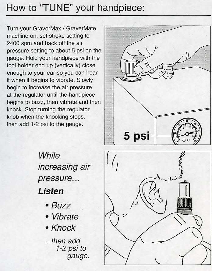

Hello all, I would like to know how would i go about stripping the chrome finish off a derringer so it can be engraved. Also i have a GRS Gravermax Bulino Graver Hand Piecethat i purchased from ebay. It is a brand new piece but didnt come with any instructions, Just how to dismantle it. Can someone tell me how to get it going. -Thank you very much. :)

Yadram,
You can get the product manuals at grstools.com, look under product resources.
Jim

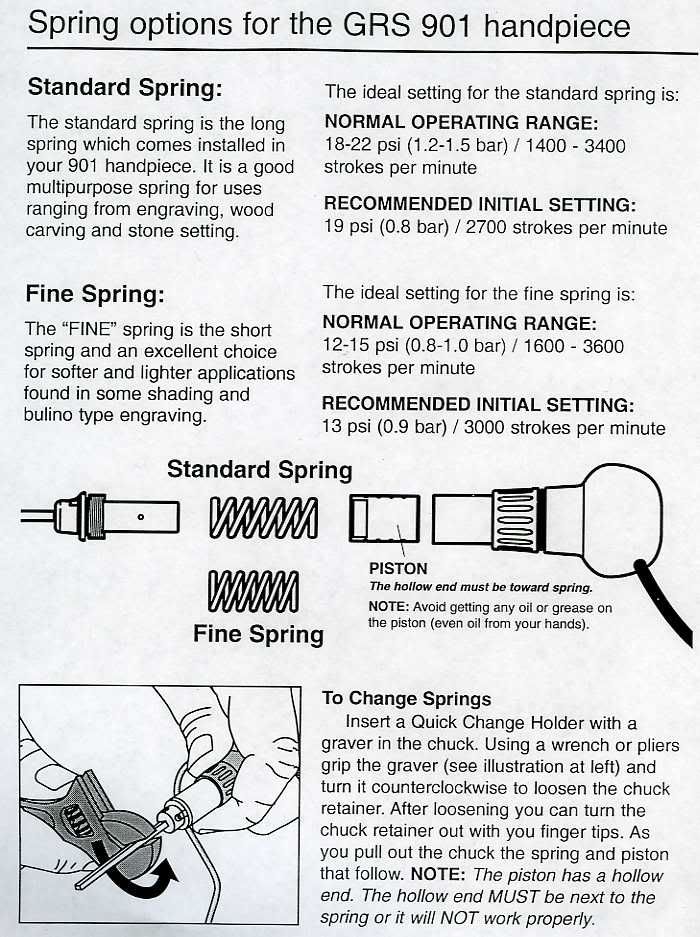

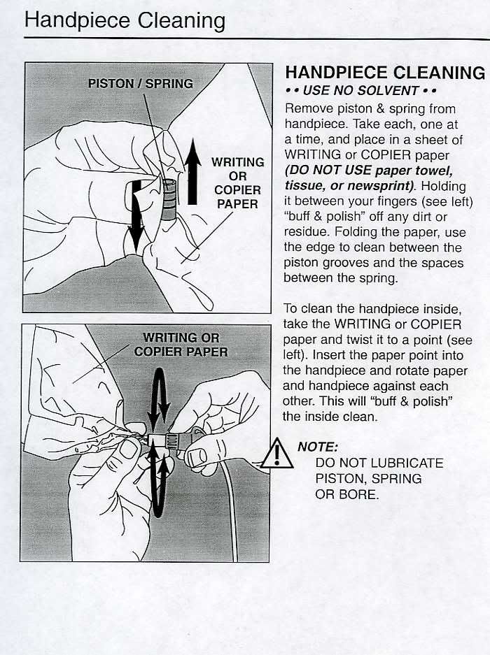

some misc grs info on 901 I think
Barry Lee Hands
12/1/2005 12:56:03 PM
Barry Lee Hands
12/1/2005 12:57:36 PM
Barry Lee Hands
12/1/2005 12:58:31 PM
Barry Lee Hands
12/1/2005 12:59:13 PM
