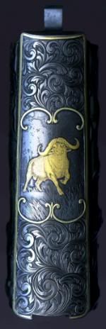

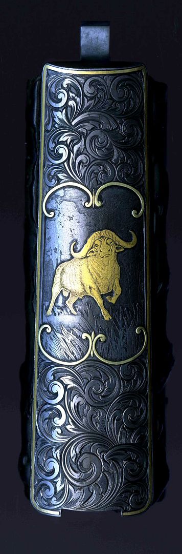

John, thought I would thank you for sending me the Buff, and let you see what I did with it, Thanks again buddy, BLH
Barry Lee Hands
12/11/2005 4:52:04 PM
You're welcome Barry.
Outstanding job..... one mean looking guy!
That sure didn't take you long to complete the whole floorplate.
Bye the way Barry, I hope you post a picture of it lifesize to give some of the folks an idea how great it aso looks in real life, to the naked eye.
Merry Christmas to you and all the other Metal Peckers.
John.
John Barraclough
12/11/2005 5:59:23 PM
Ok, here is a teeny one. It took longer than I expected, I started it friday, inlayed the borders,inlayed the gold buff, noticed some teeth poking through, so I tore it out, dug a little deeper, reinstalled the gold, engraved the scrollwork, then etched the scene, and inlayed the cartouche, then punched up and bulino'd the buff.

nice work Barry .I do like your scroll work . and thanks for sharing your work with us .. Ron

Hey, Barry.
I've had a couple of those wayward burrs myself over the years and have devised a couple of methods to deal with them which don't require digging out the gold.
I expect you know about them, but let me know if you or anyone else needs this information.
I really like the small picture, thank you for posting it.
John
John Barraclough
12/12/2005 7:21:27 PM
You should post your methods, maybe we will learn new ways to get rid of burrs. I have a few myself, but I had too many to attack one at a time, the cavity was big enough, I just raised them too high, and well, hehe...
